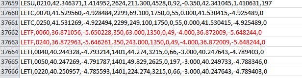

Esto es lo que aparece en el fichero r4.csv que como dices, es leído por AhsBender:
LETC,0250,41.531269,-4.922494,2299,249.100,1750,0,55,0.000,41.530415,-4.925489,0
LETF,0060,36.871056,-5.650228,350,63.000,1350,0,49,-4.000,36.872009,-5.648244,0
LETF,0240,36.872963,-5.646261,350,243.000,1350,0,49,-4.000,36.872009,-5.648244,0
LETI,0040,40.244328,-4.793214,1401,44.274,3215,0,66,-3.000,40.247643,-4.789403,0
Si esta muy raro
Si esta muy raro
